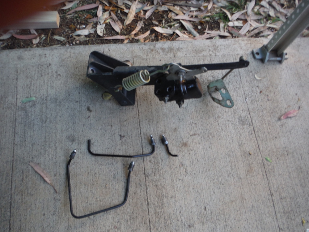

goingbush
Messages : 35
Enregistré le : mar. 13 janv. 2015 11:01
Re: Iveco 55S17W Brakes
Message par goingbush »
Yesterday I removed that Load Compensating Valve, carefully re-bend and connect the pipes from the front (ABS modulator) direct to the rear brakes.
I had to cut one pipe and replace M12 pipe union with M10 pipe union because holes in the valve are different sizes.
Previously I had the arm on that valve adjusted in different positions, but never really felt much better, now the brakes are actually working because for the first time I can hear them squeal !!!
Iamat66

Message par Iamat66 »
Good idea Don.
Here is a Video wehre You can see that the load compensating valve don't modulate the braking force.
With your change, you have increased the rear braking force close to 20%
@++ René

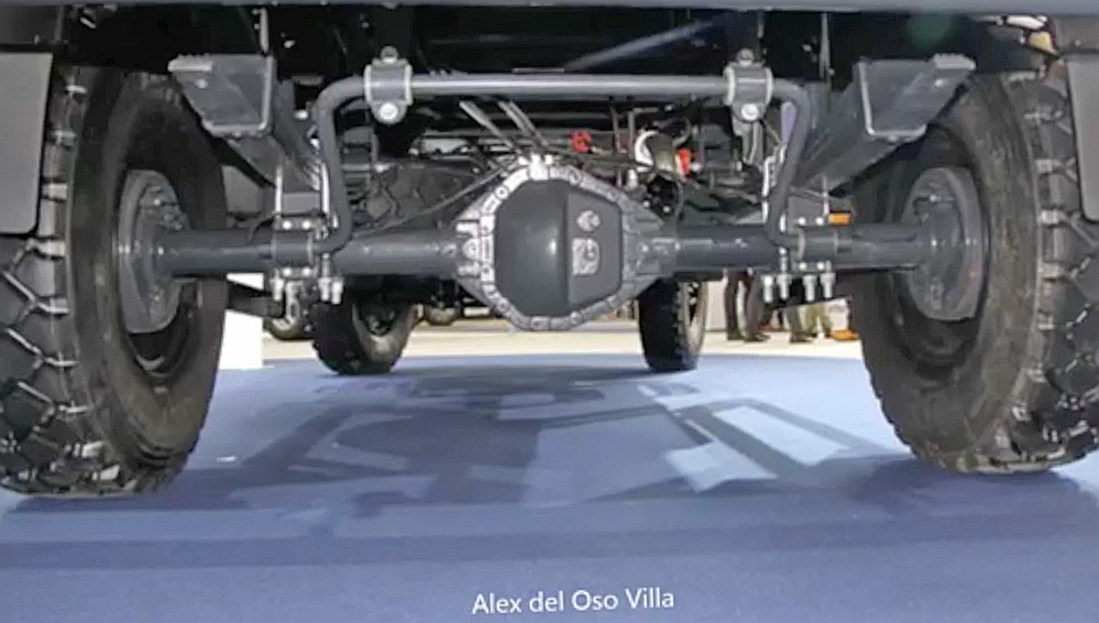

Messages : 4718
l'Iveco exposé à Bad Kissingen sur le stand Bimobil permet de détailler les dessous affriolants de la bête (Nombreux tuyaux, AD Blue...)
Jacomo32
Messages : 2928
Message par Jacomo32 »
Est-ce que la BT est toujours la même ?
Iveco parlait de modifications de suspension (sur le 4x2), y en a-t-il sur la version 4x4 ?
Bonne visite

goingbush
Messages : 35
euro6 , thanks for posting
do you have a higher resolution image , I'd like to use that on my website about bad 55S17W Brakes . :aille:
